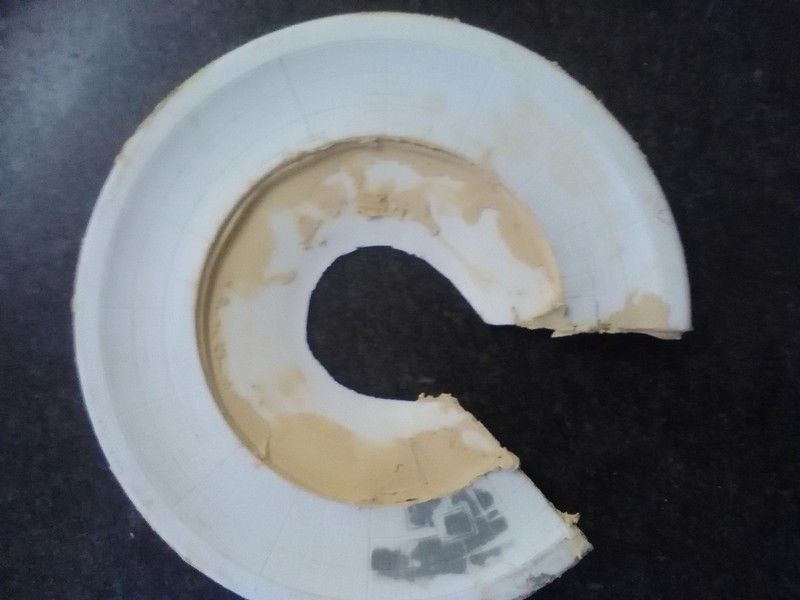

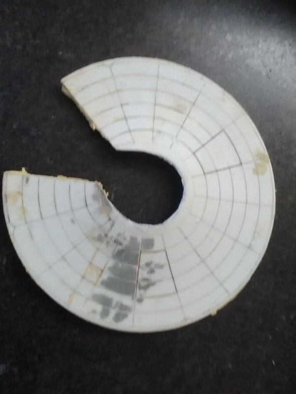

I started with an old 1/537 refit hull that I built 20+ years ago twice and was painted with several layers of enamel paint
I used some oven cleaner from Poundland to remove the paint letting it soak for a couple of weeks it mostly worked, enough to be useable
I also cut a hole in the top of the hull to fit a 1/350 Bridge and B/C deck in and cut off the botton of the hull to remove the underside curve

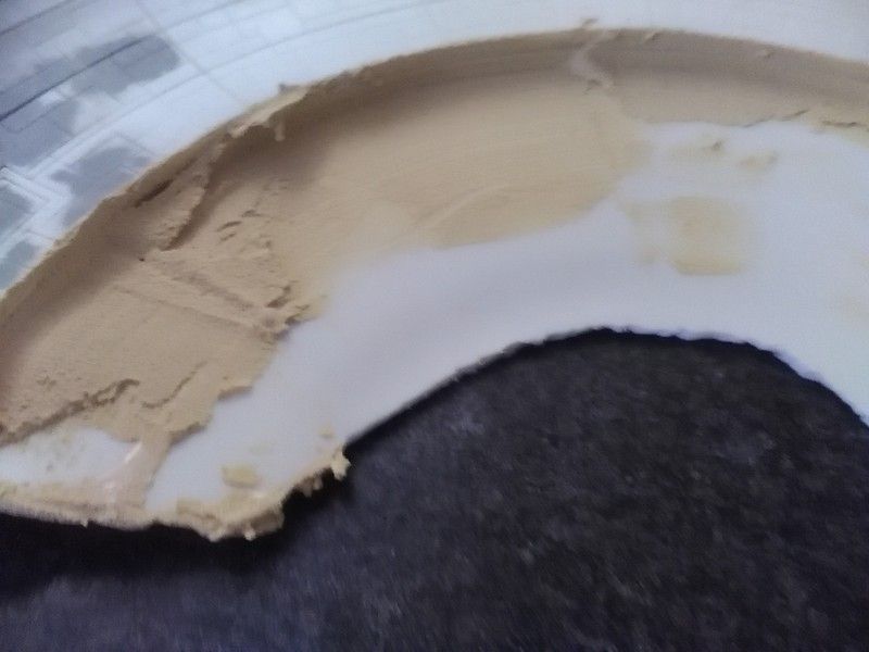

to give reinforcement to the remaining hull I used a wood filler I found at a local B&Q and had tried out on another kit
This stuff sets hard but sands very smooth and as I wasn't lighting the kit it didn't matter if I filled most of it

I used my silhouette to cut some sheet styreen as a level to work to
and filled to the new line to hold the hull
the bit of the hull cut off earlier was re-attached to give some shape back

Coating the bottom of the hull got a coat of filler
and the first sanding began
It wasn't perfect on the first go
some holes and some extra needed
after a bit of fill and a sand with finer grit starting to look right
a little bit of green putty dealt with the last bits
